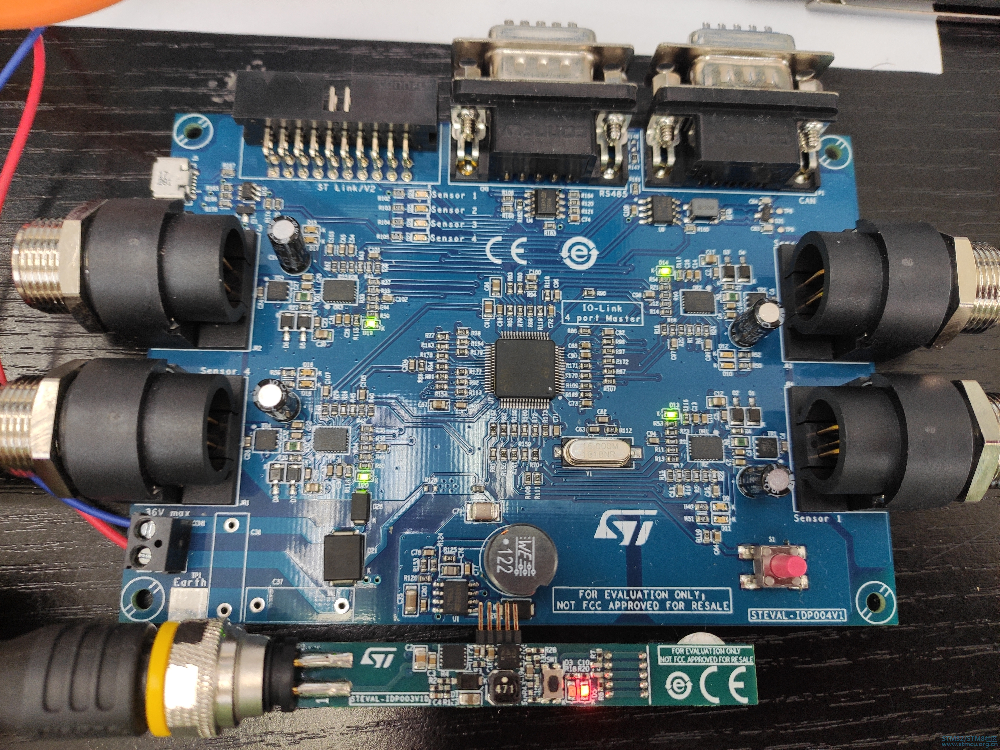

Hello, ST company. I bought your development board steval-idp004v1 and steval-idp003v1 about IO-Link. But I have a problem.

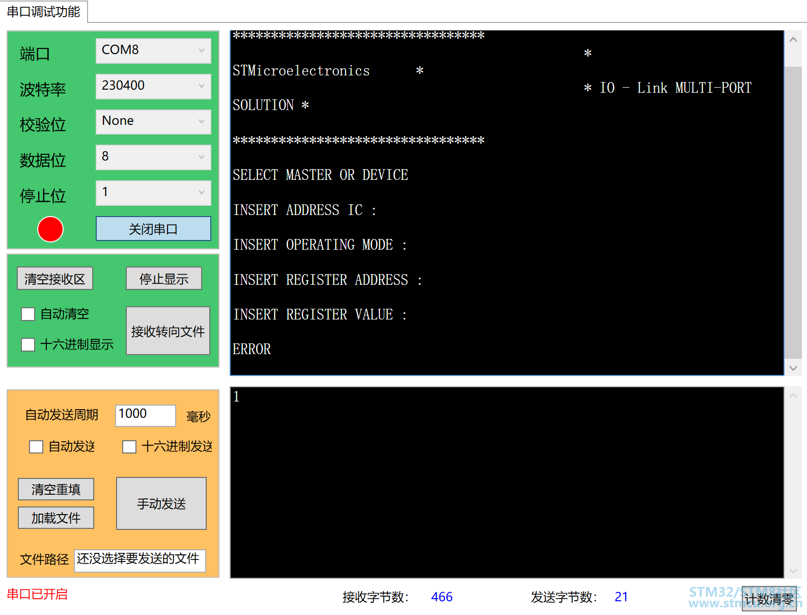

The downloaded program does not follow the instructions in the documentation (STEVAL-IDP004V1's green light flashes, STEVAL-IDP003V1's green light flashes). The result is that STEVAL-IDP004V1 has no lights flashing and STEVAL-IDP003V1 has a red light. I used the USB connection development board and entered the programmatic actions in the documentation that still responded, but could not INSERT REGISTER VALUE: this step. My downloaded programs are all from

ST公司您好,我购买了你们关于IO-Link的开发板STEVAL-IDP004V1,STEVAL
-IDP003V1。但是我遇到了问题。
下载的程序并没有按照说明文档中的正常运行(STEVAL-IDP004V1的绿灯闪烁,STEVAL-IDP003V1的绿灯亮)。下载完后的现象是STEVAL-IDP004V1没有灯闪烁,STEVAL-IDP003V1红灯亮。我使用USB连接开发板,输入说明文档中的编程操作仍然有反应,但是无法通过 INSERT REGISTER VALUE: 这一步。我的下载的程序均来自于
