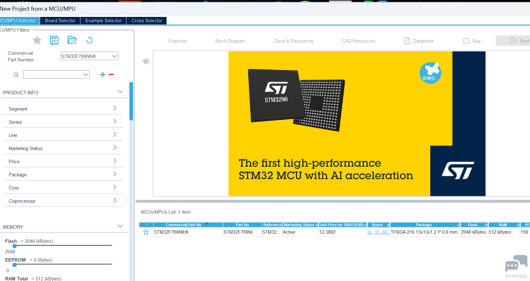

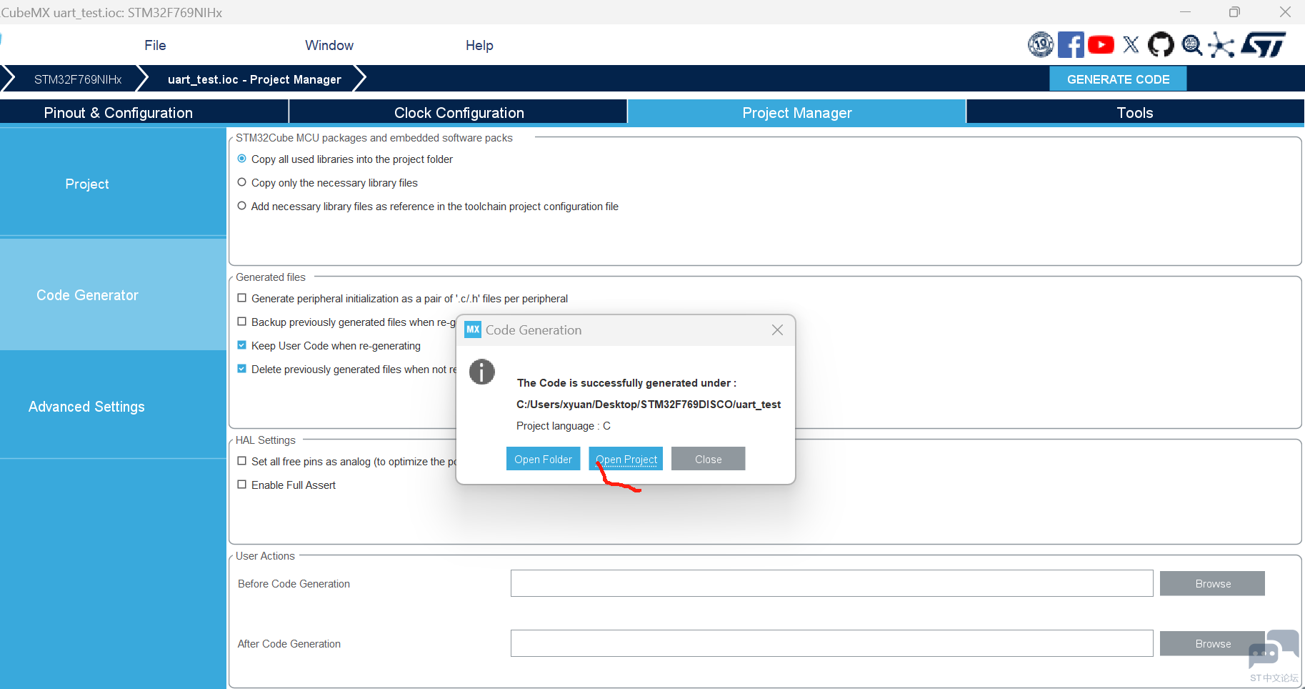

1。打开cubemx

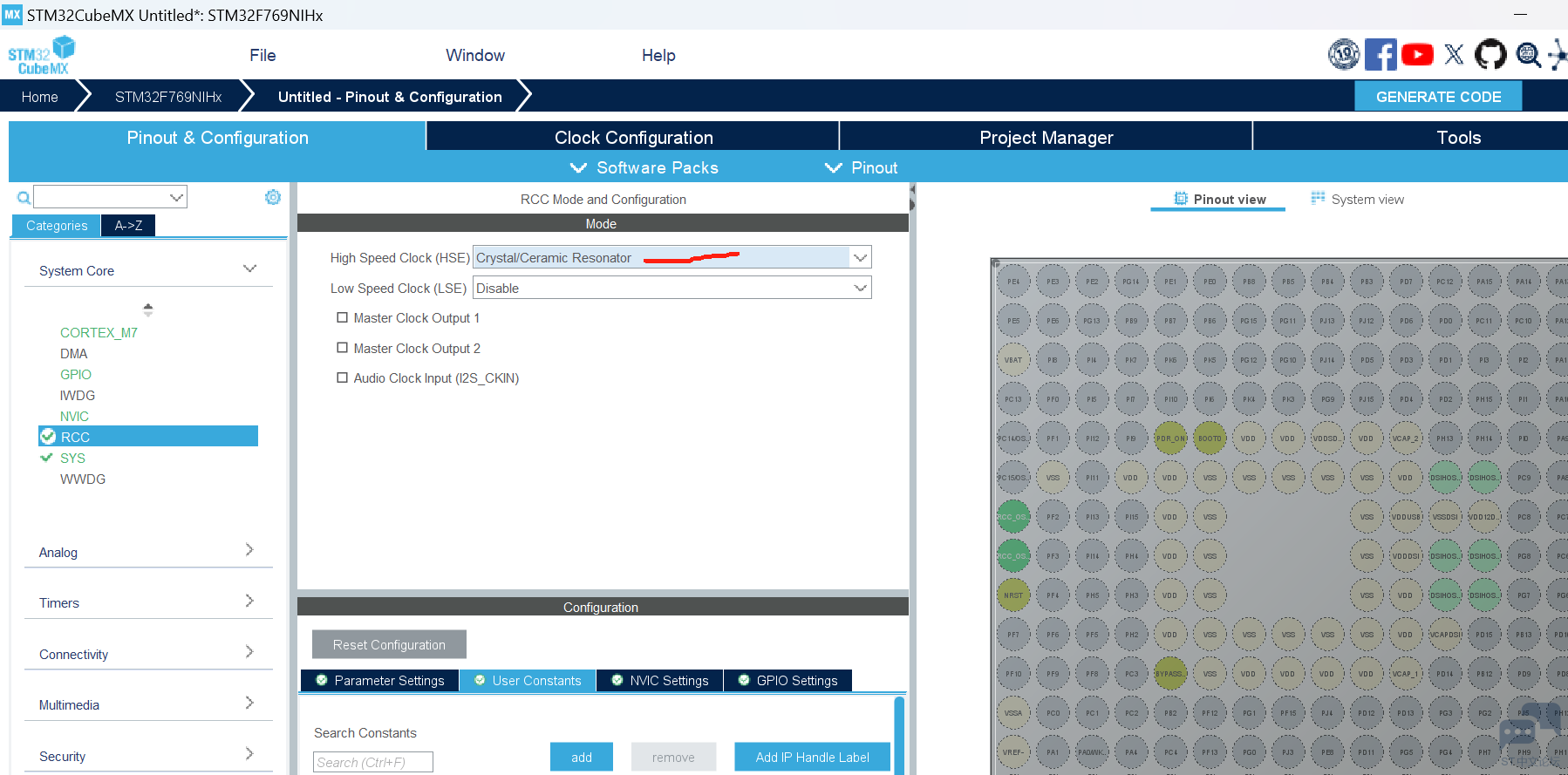

选择STM32F769BIH6

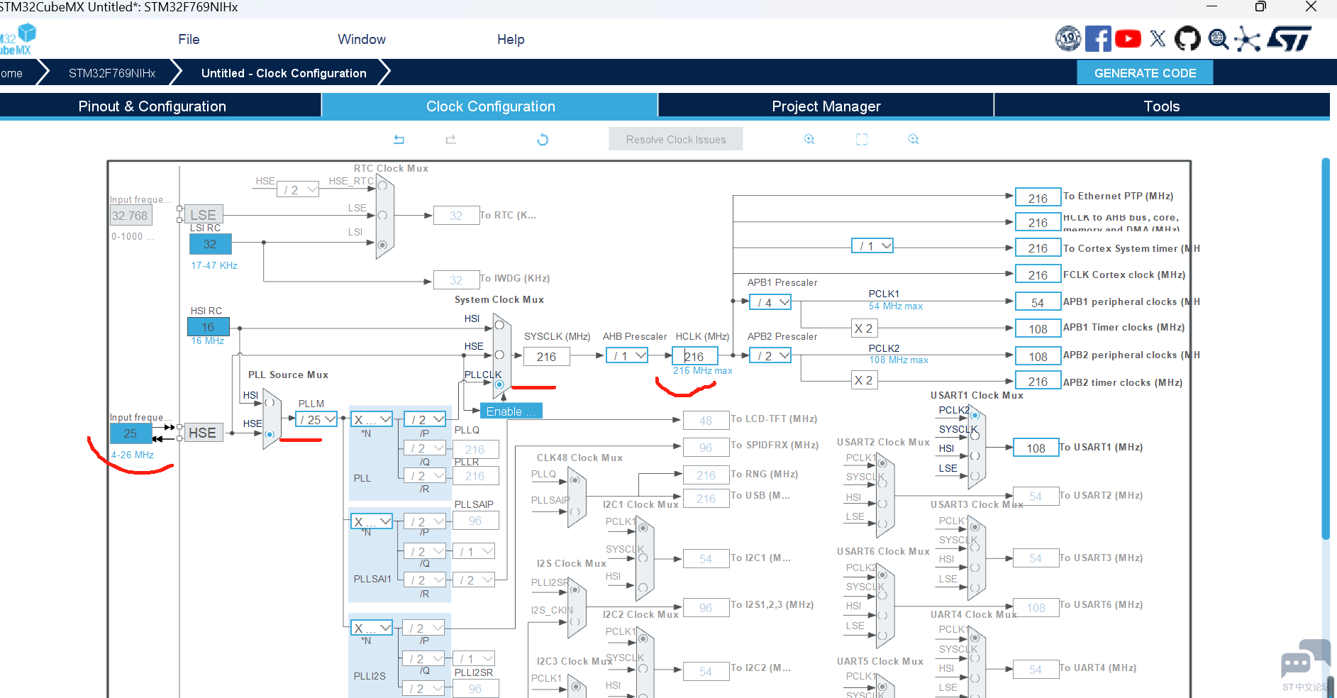

2。使能外部时钟,配置时钟树

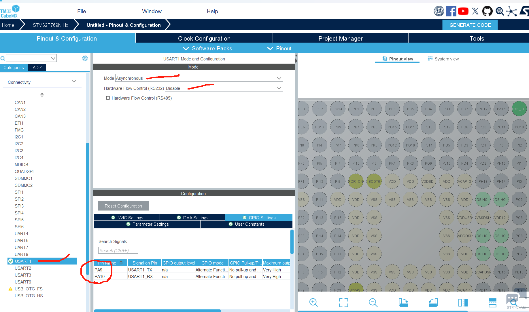

3。配置串口

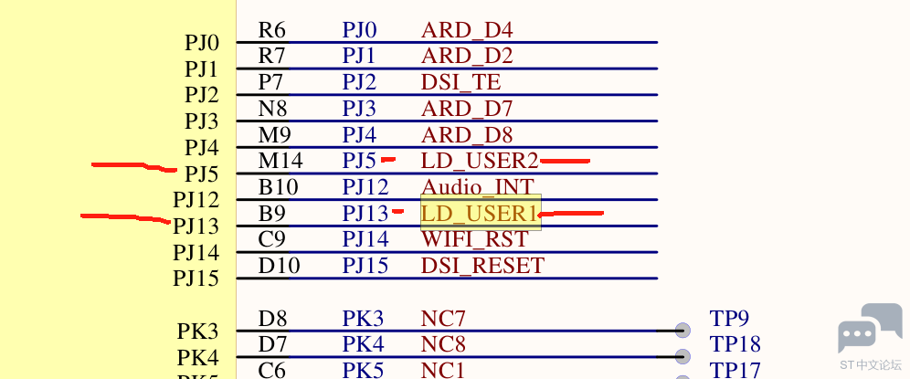

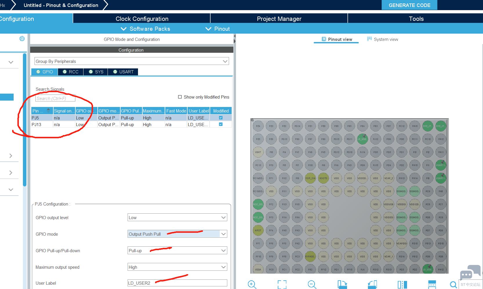

4。配置LED1 LED2

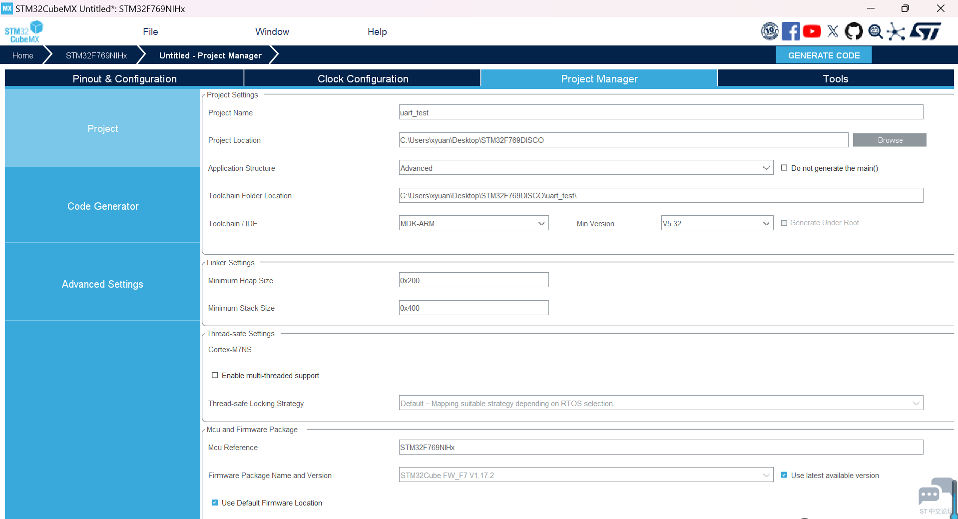

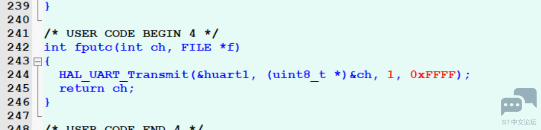

6.打开KEIL,重定向printf
int fputc(int ch, FILE f) { HAL_UART_Transmit(&huart1, (uint8_t )&ch, 1, 0xFFFF); return ch; }

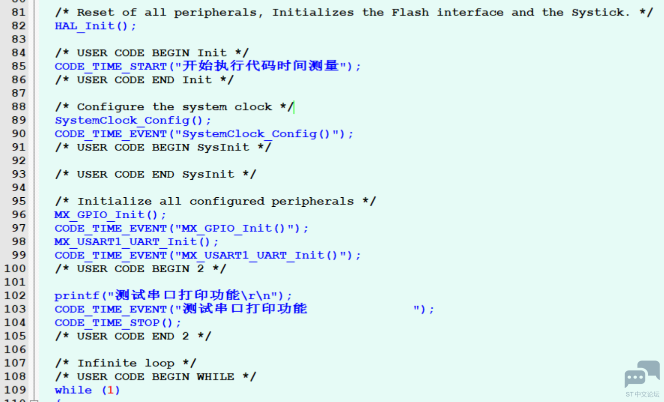

7。修改代码
/ Reset of all peripherals, Initializes the Flash interface and the Systick. / HAL_Init();
/ USER CODE BEGIN Init / CODE_TIME_START("开始执行代码时间测量"); / USER CODE END Init /
/ Configure the system clock / SystemClock_Config(); CODE_TIME_EVENT("SystemClock_Config()"); / USER CODE BEGIN SysInit /
/ USER CODE END SysInit /
/ Initialize all configured peripherals / MX_GPIO_Init(); CODE_TIME_EVENT("MX_GPIO_Init()"); MX_USART1_UART_Init(); CODE_TIME_EVENT("MX_USART1_UART_Init()"); / USER CODE BEGIN 2 /
printf("测试串口打印功能\r\n"); CODE_TIME_EVENT("测试串口打印功能 "); CODE_TIME_STOP(); / USER CODE END 2 /

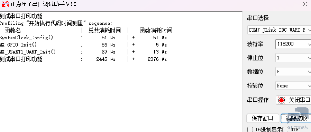

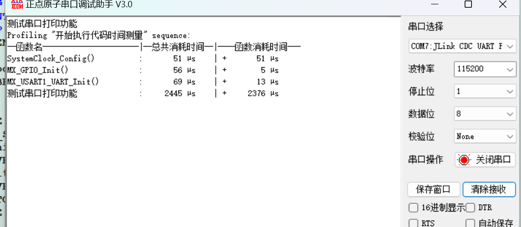

烧录,打开串口助手查看
